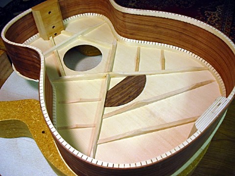

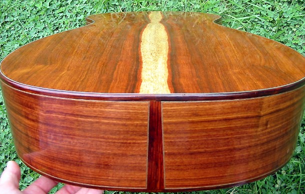

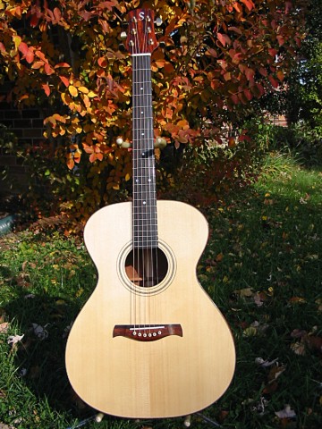

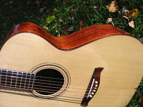

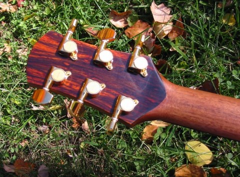

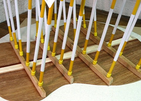

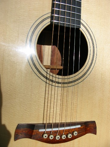

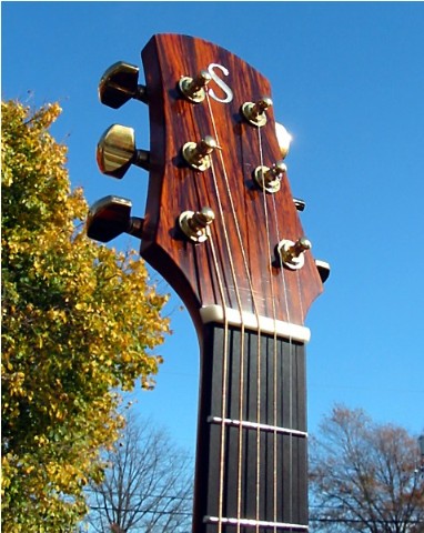

Here's what's coming off my bench. It still needs a label, clear pickguard, swap out saddle & bridge pins,and a case from Access, if they ever arrive...
Grenadillo B & S
Engleman top & braces
Mahogany back braces
Mahogany one piece neck
Cocobolo bridge, binding, end wedge, headstock overlays and scrap samples (Thanks to Bob Cefalu)
Ebony FB 12" Radius, 25.4" scale, gold tube side dots (Thanks to Paul Woolson)
Gold Goto tuners 18:1 ratio
K & K pure western mini pickups (Bruce Dickey-you're SO gracious!) Bruce's link for K & K pickups
NOTE: Bridge outline is NOT mine. I used a slightly modified Lance Kragenbrink/John Osthoff design till I work out my own. I just don't want to take credit for somone else's work here.
This guitar is getting broken in Wednesday 11/9 at a Rita Springer concert at my church, day before my birthday! What a treat all the way 'round. And I just celebrated my 11th yr anniversary, and have a baby due, all in one week!
Life's good, God's GREAT.
This one is just with Zpoxy. Can't tell can you?
PREQUEL SHOTS

Very nice!   What is the finish?

The finish is ktm-9. Grits 400, 600, 1000, 1500 then to micromesh, med & fine buffing wheel, and then lotsa elbow grease with the Meguire's swirl remover. Perhaps a #7 THEN swirl remover. We'll see. I've got another d-28 ready for sanding/buffing. That finishes curing when the baby's due.
I left the nck sanded to 1000 and straight to swirl remover to even out the finish. KTM-9 feels MUCH better in satin than gloss on the neck. I did polish the headplate veneers. The pix makes it look REALLY cheesy though.

Niiiice...how 'bout you give us a nice full frontal so we can appreciate the shape fully? Also, where would one find Grenadillo sets at decent prices? I've seen a good number of guitars made out of it so far, and each has been more beautiful than the last.

PostPosted: Tue Nov 08, 2005 2:49 am
Very nice! I love that backstrapped peghead!

[QUOTE=Mattia Valente] Niiiice...how 'bout you give us a nice full frontal so we can appreciate the shape fully? Also, where would one find Grenadillo sets at decent prices? I've seen a good number of guitars made out of it so far, and each has been more beautiful than the last.[/QUOTE]
Lmi had them for $63/set. Frontal shot to follow, got a lot to do today.... BTW It's a Taylor GC style body
